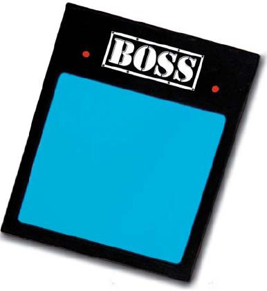

PS. I know I already recommended three helmets but I have to mention just one more…...The Jackson BOSS lens cartridge and HellRaiser helmet. This lens has the largest viewing area of any lens in the world!
BOSS
