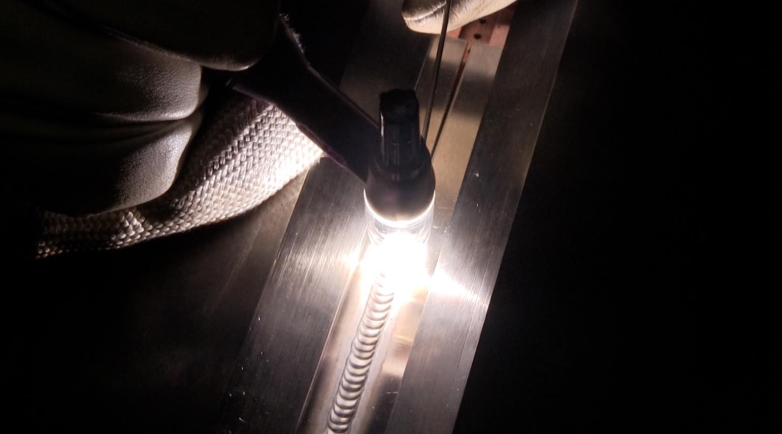

In the video above, I am TIG Welding Carbon Steel to stainless in a crude purge fixture I made over 30 years ago.
The stainless is .062” thick and the carbon steel is .040” .
A slight difference in thickness is not a big deal and I used a 1/16” diameter 312L TIG rod
312L tig rod is very crack resistant and is great for tig welding dissimilar metals like stainless to carbon, or even for tig welding 4130 chromoly to carbon steel or high strength steel.
312L TIG rod is a great all purpose rod that works for all kinds of different steels. Its a great rod to have because if the metal is unknown but is some type of steel, 312 will probably work.
Stainless steels, carbon steels, 4130, tool steels, nickel alloys, or practically any combination of these can be joined using 312 stainless rod.
I have a really nice purge fixture made for me by ABOM79 (Adam Booth) and it works great.
In fact,  I have shown it in use on several other videos on aerospace welding tests.
But just for kicks I used a very crude fixture that I cobbled together many years ago out of 1/2” plate using only a plasma cutter and a grinder.
This was the fixture I used to get started testing welders while waiting for some more precision fixtures to be made.
When you make a full penetration weld on stainless, shielding the back side with argon is necessary to avoid a condition called granulation aka “sugaring”.
A purge fixture takes care of purging the back side of the weld and holds thin  pieces in place while you tack and weld.
Sometimes you might be required to tack weld both ends without a gap, but
positioning the pieces with a gap at one end might be an option.
 It really just depends on the policies and procedure used.  And of course the person  administering the test.
In my experience, unless you really crank down on the chill bars, a 1/8” gap will close up in a 6 inch piece.
The way the gap shrinks illustrates the shrinkage stresses as a weld progresses.
Here are the details and settings used.
.062” 304L stainless welded to .040” 1018 carbon steel
10-15 cfh flow of purge gas on fixture
MK 14 cup 30-33 cfh argon
1/16” 312L filler rod
3/32” 2% lanthanated tungsten ( a 1/16" would be more common for most aerospace welding tests in the 40 amp range)
40 amps using a primeweld 225
Aerospace Welding Test and Fixture built by Abom79

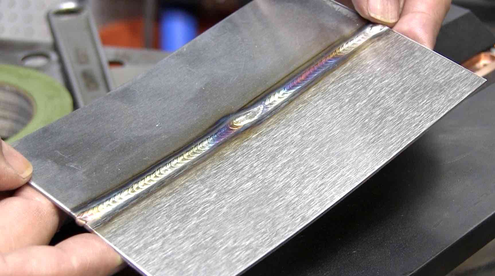

The chill plates are adjustable to accommodate different metals thermal conductivity and different thicknesses.
For stainless and nickel alloys as well as titanium and cobalt alloys, having the chill bars very close to the bead can help the end result.
For aluminum and magnesium, moving the chill bars out a bit farther seems to work better by slowing the cooling rate of the weld. ( slower cooling rate can help prevent porosity)
stainless test plate d17.1
the pic below shows what I have found helps in preventing crater cracks when stopping.
...a slow tapering off the amperage while adding less and less filler
stainless taper amperage test plate d17
