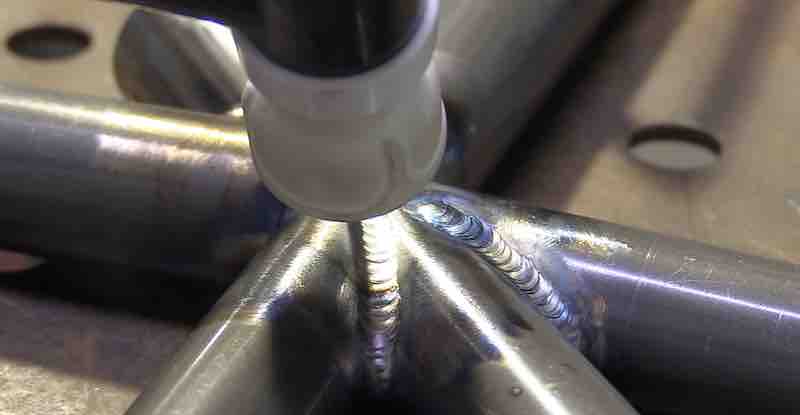

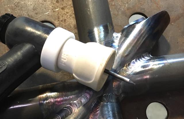

After making several small tack welds, I welded one side at a time and let cool after each run.
I found that using the Furick Ceramic 12 cup. I was able to utilize a 3/4" stickout and easily reach the tight throats of each joint.
Welding Procedure Used for this 4130 chromoly tubing cluster
  • Base Material Type/Thickness - 1" 4130 chromoly tubing .063" wall thickness
  • Prep Method - flap disc to remove mill scale followed by acetone wipe
  • Filler Metal Type/Size - ER80S-D2 .045"
  • Tungsten size and prep - 3/32" 2% lanthanated sharpened to 30%
  • Gas Type and Flow Rate- argon 25-30cfh
  • Cup size - Furick Ceramic 12 (available at weldmonger.com)
  • Current/Polarity - DCEN 65 amps
  • Length of Arc - equal or less than 3/32"
  • Angle of Travel - usually 15% but angle changes on cluster joints
  • Manipulation/Technique - dip, travel, pause
  • Speed of Travel - 4-5 inches per minute
