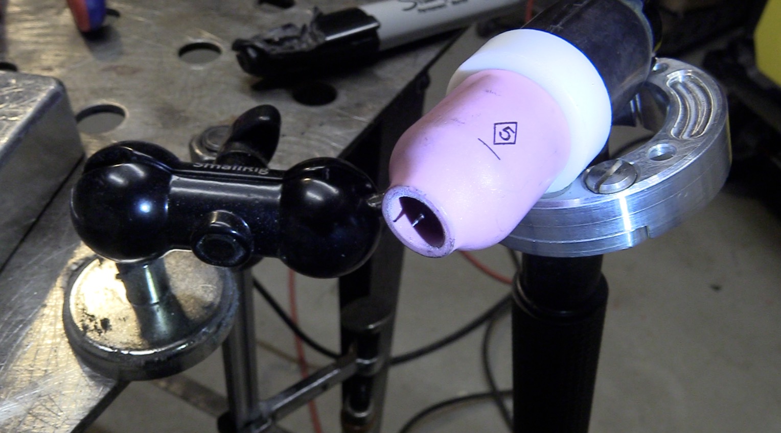

Flash Tacking with a #5 stubby gas lens cup, TIG welding with Chill Bars and without , using a Jazzy 10 ceramic cup, and plenty more.

Tungsten size and prep - 3/32" 2% lanthanated 30 degree taper
Gas Type and Flow Rate - Argon 20cfh Jazzy 10 cup
Cup size - jazzy 10 ceramic from weldmonger.com

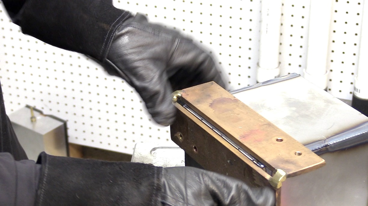

Chill Bars
I save scrap pieces of thick aluminum for use as chill bars on sheet metal welding like this.
I have done quite a bit of work for machine shops over the years and they always have short pieces of thick aluminum they are willing to give away or sell for cheap ...so I have several different shapes.
I also made a simple outside corner tool out of copper.
Its best of you can clamp chill bars down tight so that they pull heat out of the part...but even when you cant, they still help a lot in trapping argon gas and allowing for better gas shielding.
Maybe not that important on carbon steel, but same principle applies for stainless.
Chill bars really make a difference on stainless.
